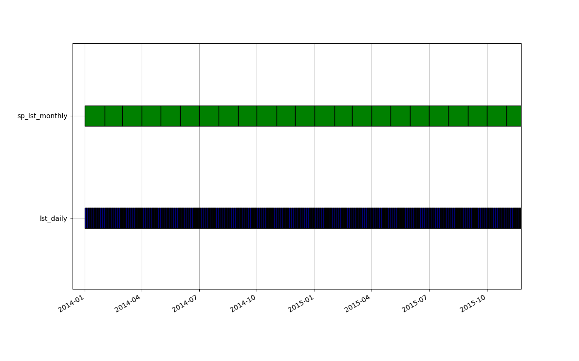

Let’s now compare the values obtained by querying the monthly LST time series with those resulting from aggregating the daily LST time series. They should be the same. For that we need to specify the sampling relation. The temporal tool that allows to specify sampling relations and do temporal aggregation is t.vect.what.strds. It requires a STVDS as input, so we’ll use the one we just obtained above. We also specify the start relation, so all maps in the STRDS which start time matches the STVDS will be aggregated. Let’s see this graphically before running the tool.
Comparisaon of granularities
gs.run_command("t.vect.what.strds",
               input="sp_lst_monthly",
               strds="lst_daily",
               column="lst_new",
               method="average",
               sampling="start")
gs.run_command("t.vect.db.select",
               input="sp_lst_monthly")
As expected, results are exactly the same! So, if you are constrained by disk space for example, you don’t need to aggregate your entire STRDS if you only need aggregated values for a set of points.
