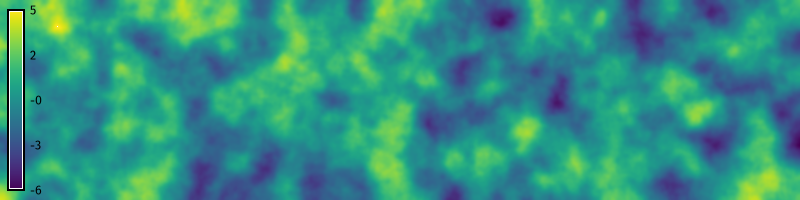

Gradient Noise
The original form of gradient noise - Perlin noise - is generated by interpolating between random gradient vectors on a grid and their offsets [8]. We will use map algebra to generate a generalized form of gradient noise by progressively smoothing a random raster surface. First create a random surface using the raster calculator r.mapcalc. Use formatted string literals to insert variables into raster calculator expressions in Python scripts. Then use a for loop to progressively smooth the random surface using nearest neighbors analysis with r.neighbors. Calculate the average neighborhood using a circular moving window. The key parameters for our gradient noise function are the seed of the pseudo-random number generator, the amplitude of the surface, the iterations of smoothing, and the wavelength of the moving window. Experiment with these parameters. Try setting different values for each of them. Then try using random walks generated with r.random.walk or a fractal surface generated with r.surf.fractal instead of a random surface.
# Set parameters
seed = 0
amplitude = 100.0
iterations = 3
wavelength = 33
# Generate random surface
gs.mapcalc(f"noise = rand({-amplitude}, {amplitude})", seed=seed)
# Generate gradient noise
for i in range(iterations):
    # Smooth noise
    gs.run_command(
      "r.neighbors",
      input="noise",
      output="noise",
      size=wavelength,
      method="average",
      flags="c",
      overwrite=True
# Set color gradient
gs.run_command("r.colors", map="noise", color="viridis")
# Visualize
m = gj.Map(width=800)
m.d_rast(map="noise")
m.d_legend(raster="noise", at=(5, 95, 1, 3))
m.show()
Gradient noise

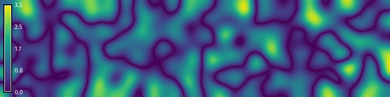

Billow Noise
Billow noise or turbulence is a variation of gradient noise. After generating gradient noise, use the raster map calculator r.mapcalc to take the absolute value of the noise raster. This will transform pits and valleys into peaks and ridges and form new valleys near zero elevation, creating a billowing cloudy effect.
# Set parameters
seed = 0
amplitude = 100.0
iterations = 3
wavelength = 33
gs.mapcalc(f"noise =  rand(-{amplitude}, {amplitude})", seed=seed)
# Generate perlin noise
    # Smooth noise
    gs.run_command(
      "r.neighbors",
      input="noise",
      output="noise",
      size=wavelength,
      method="average",
      flags="c",
      overwrite=True
# Calculate absolute value
gs.mapcalc("turbulence =  abs(noise)")
# Visualize
m.d_rast(map="turbulence")
m.d_legend(raster="turbulence", color="white", at=(5, 95, 1, 3))
m.show()
Billow noise

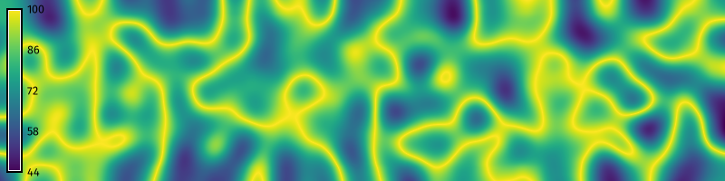

Ridge Noise
Ridge noise is another variation of gradient noise. After generating gradient noise, use the raster map calculator r.mapcalc to subtract the absolute value of the noise raster from an offset and then raise it to an exponent. This will transform the valleys of billow noise into ridges. The key parameters for our ridge noise function are the seed of the pseudo-random number generator, the amplitude of the surface, the iterations of smoothing, the wavelength of the moving window, the offset of the ridges, and the exponent for scaling the ridges.
# Set parameters
seed = 0
amplitude = 100.0
iterations = 3
wavelength = 33
offset = 10
exponent = 2
    # Smooth noise
    gs.run_command(
      "r.neighbors",
      input="noise",
      output="noise",
      size=wavelength,
      method="average",
      flags="c",
      overwrite=True
# Calculate ridge function
gs.mapcalc(f"ridge =  exp({offset} - abs(noise), {exponent})")
# Visualize
m.d_rast(map="ridge")
m.d_legend(raster="ridge", at=(5, 95, 1, 3))
m.show()
Ridge noise

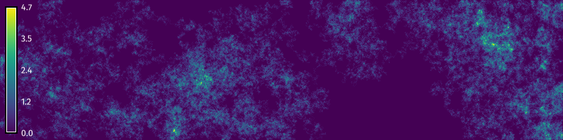

Fractal Noise
Fractional Brownian motion is a random walk through space that is contingent on past steps and has self-similar fractal properties. Fractal noise can be generated from fractional Brownian motion by accumulating octaves, i.e. iterations, of procedural noise with incremental changes in frequency and amplitude [1, 4, 9]. First, use the raster map calculator r.mapcalc to create a constant surface. Then use a for loop to iterate through each octave. For each octave, generate gradient noise, add the gradient noise to the prior surface using r.mapcalc, and then increment the function’s fractal parameters. The key parameters for our fractal Brownian motion function are the seed of the pseudo-random number generator, the amplitude of the surface, the iterations of smoothing, the wavelength of the moving window, the octaves for accumulating noise, the lacunarity or change in frequency of each octave, and the gain in amplitude for each octave.
# import libraries
import random
# Set parameters
seed = 0
amplitude = 100.0
iterations = 3
wavelength = 33
octaves = 6
lacunarity = 0.5
gain = 0.2
# Generate zeros
gs.mapcalc("fbm = 0")
# Generate fractional Brownian motion
for octave in range(octaves):
        # Smooth noise
        gs.run_command(
          "r.neighbors",
          input="noise",
          output="noise",
          size=wavelength,
          method="average",
          flags="c",
          overwrite=True
    # Calculate sum of gradient noise maps
    gs.mapcalc("fbm = fbm + noise")
    # Increment parameters
    amplitude = amplitude * gain
    wavelength = round(wavelength * lacunarity)
    if wavelength % 2 == 0:
        wavelength += 1
# Visualize
m.d_rast(map="fbm")
m.d_legend(raster="fbm", at=(5, 95, 1, 3))
m.show()
Fractal Brownian motion

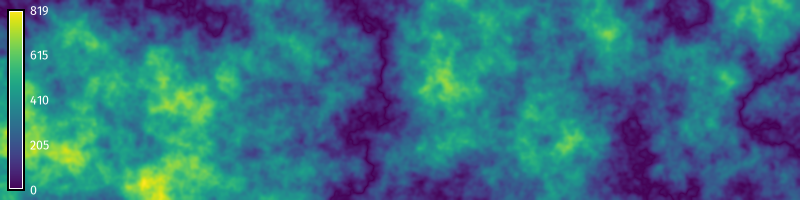

Multifractal noise
Multifractal noise can be generated by more complex incremental accumulations of procedural noise [5, 6]. In this example we will model multifractal Brownian motion by accumulating octaves of turbulent fractal gradient noise. First, use the raster map calculator r.mapcalc to create a constant surface. Then use a for loop to iterate through each octave. For each octave, generate a fractal surface with r.surf.fractal, progressive smooth this surface in a nested for loop to model fractal gradient noise, add the absolute value of fractal gradient noise to the prior surface scaled by amplitude, and then increment the function’s fractal parameters. Experiment with different parameters. Try multiplying fractal maps instead of adding them, but be sure to start with a non-zero constant to avoid multiplication by zero. The key parameters for our multifractal function are the seed of the pseudo-random number generator, the dimension of the fractal surface, the amplitude of the multifractal surface, the iterations of smoothing, the wavelength of the moving window, the octaves for accumulating noise, the lacunarity of each octave, and the gain in amplitude for each octave.
# Set parameters
seed = 0
amplitude = 0.1
iterations = 3
wavelength = 33
octaves = 6
lacunarity = 0.5
gain = 0.05
dimension = 2.2
# Generate zeros
gs.mapcalc("multifractal = 0")
# Generate multifractal surface
    # Generate fractal surface
    gs.run_command(
        "r.surf.fractal",
        output="fractal",
        dimension=dimension,
        seed=seed
    # Generate fractal gradient noise
        # Smooth noise
        gs.run_command(
          "r.neighbors",
          input="fractal",
          output="fractal",
          size=wavelength,
          method="average",
          flags="c",
          overwrite=True
    # Calculate sum of fractal maps
    gs.mapcalc(f"multifractal = multifractal * {amplitude} + abs(fractal)")
    dimension = dimension + gain
    amplitude = amplitude + gain
        wavelength += 1
# Visualize
m.d_rast(map="multifractal")
m.d_legend(raster="multifractal", color="white", at=(5, 95, 1, 3))
m.show()
Multifractal Brownian motion

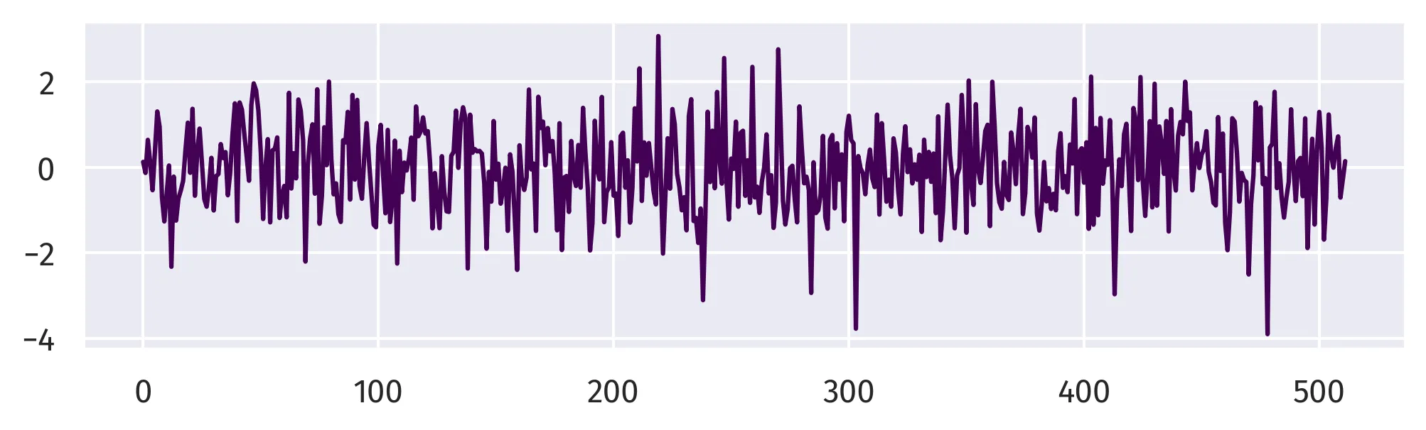

First we will plot the waveforms of one-dimensional white and pink noise with the Seaborn data visualization library [10, 11]. To generate one-dimensional white noise, instantiate Numpy’s random number generator numpy.random.default_rng, sample from a standard normal distribution with numpy.random.Generator.standard_normal, and plot with seaborn.lineplot.
# Import libraries
import numpy as np
import seaborn as sns
# Set parameters
seed = 0
n = 512 # number of samples
# Generate white noise
rng = np.random.default_rng(seed)
noise = rng.standard_normal(n)
# Plot waveform
sns.lineplot(data=noise, color=(0.26, 0.004, 0.33))
1D white noise

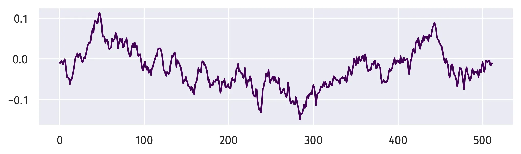

To generate one-dimensional pink noise, first compute the Fast Fourier Transform of the white noise with numpy.fft.rfft, then scale the transformed noise by \(1 / f^\alpha\), compute its inverse Fast Fourier Transform with numpy.fft.irfft, and plot with seaborn.lineplot.
# Set parameters
alpha = 1.0 # where white=0, pink=1, red=1.5, brownian=2
# Generate pink noise
noise = np.fft.rfft(noise, n)
frequency = np.arange(1, noise.shape[-1]+1)
noise /= frequency ** alpha
noise = np.fft.irfft(noise, n)
# Plot waveform
1D pink noise

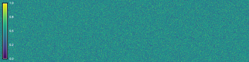

2D white noise where \(a=0\)

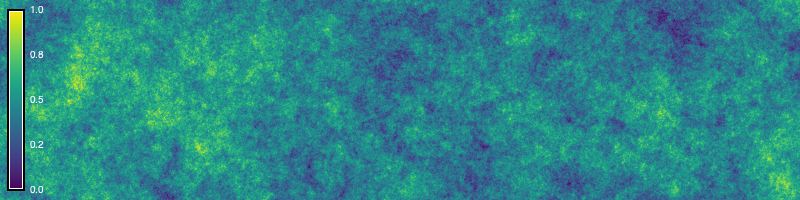

2D pink noise where \(a=1\)

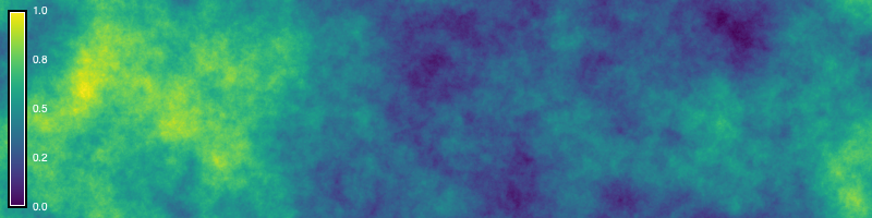

2D red noise where \(a=1.5\)

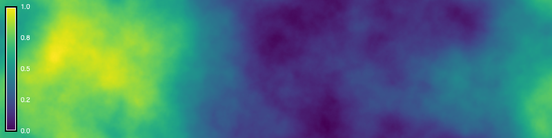

2D Brownian noise where \(a=2\)
