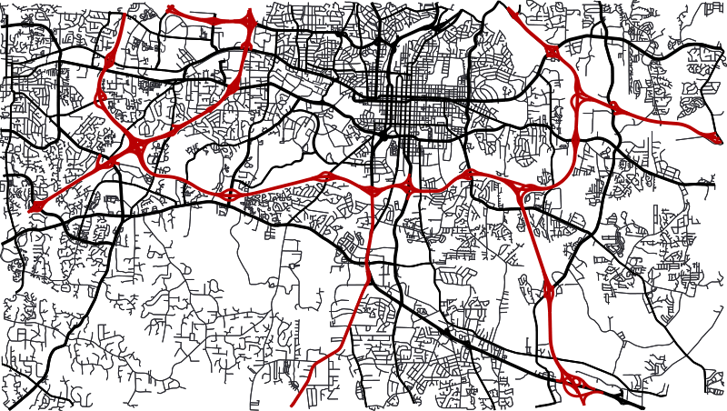

Those attributes are useful for display as well: d.vect takes a where= clause, so the same map can be drawn once per road class, with the more important classes wider and darker:
road_map = gj.Map()
road_map.d_vect(map="roads", color="#272A2C", width=1)
road_map.d_vect(map="roads", where="highway IN ('secondary', 'secondary_link')",
                color="black", width=2)
road_map.d_vect(map="roads", where="highway IN ('primary', 'primary_link')",
                color="black", width=3)
road_map.d_vect(map="roads", where="highway IN ('trunk', 'motorway', 'trunk_link', 'motorway_link')",
                color="#b70003", width=3)
road_map.show()
Roads styled by class.

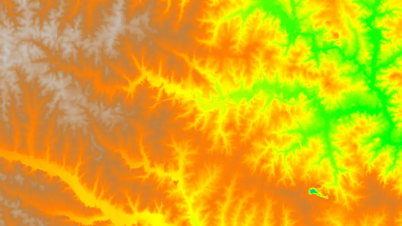

Elevation from the USGS National Map
r.in.usgs downloads, mosaics, reprojects and clips 3DEP elevation in one step. ned13sec selects the 1/3 arc-second product, roughly 10 m. Run it with -i first to see which tiles it would fetch and how large they are:
tools.r_in_usgs(product="ned", ned_dataset="ned13sec", output_name="elevation",
                flags="i", verbose=True)
tools.r_in_usgs(product="ned", ned_dataset="ned13sec", output_name="elevation")
USGS 3DEP elevation for the study area.

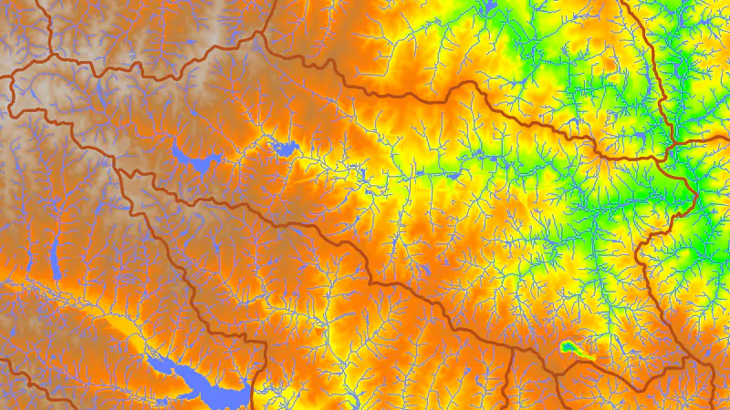

m = gj.Map()
m.d_rast(map="elevation")
m.d_vect(map="lakes", fill_color="aqua", color="none")
m.d_vect(map="streams", color="aqua")
m.d_vect(map="watersheds", fill_color="none", color="brown", width=3)
m.show()
Streams, lakes and HUC12 subwatershed boundaries over elevation.

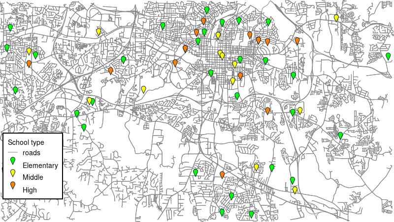

school_map = gj.Map()
school_map.d_vect(map="roads", color="gray")
school_map.d_vect(map="schools", where="elem = 'yes'", size=15, icon="basic/pin",
                  fill_color="green", legend_label="Elementary")
school_map.d_vect(map="schools", where="middle = 'yes'", size=15, icon="basic/pin",
                  fill_color="yellow", legend_label="Middle")
school_map.d_vect(map="schools", where="high = 'yes'", size=15, icon="basic/pin",
                  fill_color="orange", legend_label="High")
school_map.d_legend_vect(title="School type", flags="b", at=[2, 40])
school_map.show()
Public schools by level, over the road network.

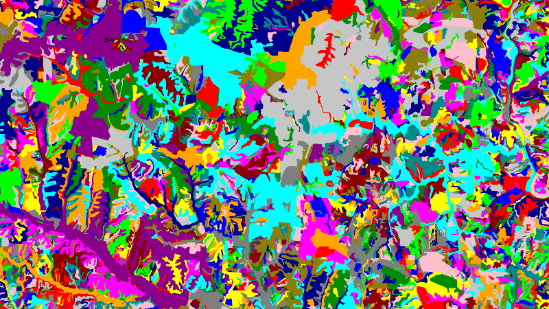

Soils from SSURGO
r.in.ssurgo queries the USDA soil survey for the current region:
tools.g_extension(extension="r.in.ssurgo")
tools.r_in_ssurgo(soils="soils_")
SSURGO comes as survey-area polygons that spill well beyond our region extent. To trim them to the region exactly, v.clip with the -r flag clips against the current region, and the soil attributes come across unchanged:
tools.v_clip(input="soils_", output="soils", flags="r")
tools.g_remove(name="soils_", flags="f", type="vector")
SSURGO soil map units clipped to the region.

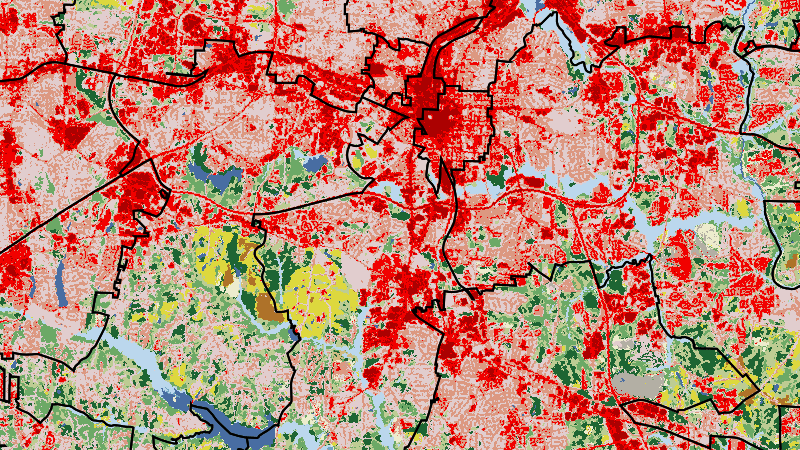

Note the year on each call. Most TIGER/Line layers are published yearly, but the pygris package supports downloading the ZIP Code Tabulation Areas only for 2000 and 2010, due to the way zipcodes are distributed.
ZIP Code Tabulation Areas over land cover.

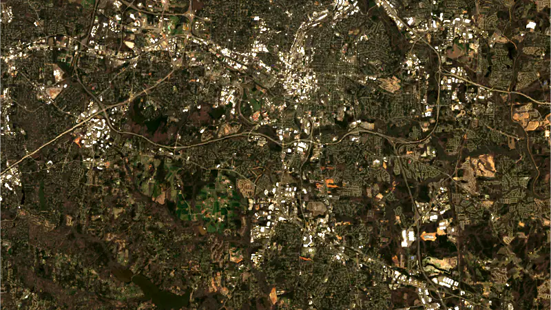

A STAC catalog: Landsat from Microsoft Planetary Computer
Satellite imagery is increasingly published through STAC catalogs, which you query by area, time and metadata. Here we ask the Planetary Computer for Landsat 8 Collection 2 Level-2 scenes over our region in spring 2025 with less than 10% cloud cover, and take the clearest:
# !pip install pystac_client planetary_computer
from pystac_client import Client
catalog = Client.open("https://planetarycomputer.microsoft.com/api/stac/v1")
search = catalog.search(
    collections=["landsat-c2-l2"],
    bbox=bbox_latlon(),
    datetime="2025-03-01/2025-07-01",
    query={"eo:cloud_cover": {"lt": 10},
           "platform": {"eq": "landsat-8"}},
items = search.item_collection()
selected_item = min(items, key=lambda item: item.properties["eo:cloud_cover"])
The assets are cloud-optimized GeoTIFFs. Planetary Computer needs the URLs signed before download:
import requests
import planetary_computer
keys = ("coastal", "blue", "green", "red", "nir08", "swir16", "swir22")
for k in keys:
    url = planetary_computer.sign(selected_item).assets[k].href
    r = requests.get(url, stream=True)
    r.raise_for_status()
    with open(f"{k}.tif", "wb") as f:
        for chunk in r.iter_content(chunk_size=8192):
            f.write(chunk)
Now the import. Left to its defaults, r.import brings in the whole file and estimates the cell size from the reprojected source. Here that means the entire Landsat scene, far larger than our study area, at some value near 30 m. We want neither: extent="region" clips each band to the computational region, and resolution="value" with resolution_value=30 pins the cell size to a round 30 m.
While we are here we attach the metadata that makes imagery usable later: a semantic label identifying which sensor band each raster is, and the acquisition timestamp:

tools.i_colors_enhance(blue="landsat8_2025_B2", green="landsat8_2025_B3",
                       red="landsat8_2025_B4", strength=98, flags="p")
landsat_map = gj.Map()
landsat_map.d_rgb(red="landsat8_2025_B4", green="landsat8_2025_B3",
                  blue="landsat8_2025_B2")
landsat_map.show()
Natural-color Landsat composite after color enhancement.

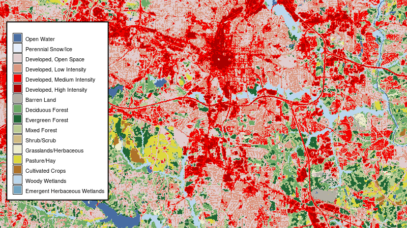

Label the categories. A land cover raster of bare numbers means nothing to a reader. r.category attaches labels, and rules can be read straight from a string with StringIO instead of a temporary file:
import io
categories = """
0:Unclassified
11:Open Water
12:Perennial Snow/Ice
21:Developed, Open Space
22:Developed, Low Intensity
23:Developed, Medium Intensity
24:Developed, High Intensity
31:Barren Land
41:Deciduous Forest
42:Evergreen Forest
43:Mixed Forest
52:Shrub/Scrub
71:Grasslands/Herbaceous
81:Pasture/Hay
82:Cultivated Crops
90:Woody Wetlands
95:Emergent Herbaceous Wetlands
tools.r_category(map="landuse", rules=io.StringIO(categories), separator=":")
tools.r_support(map="landuse", title="USGS National Land Cover Data 2024", source1="USGS")
Give it colors. GRASS ships color tables for common datasets, including NLCD:
tools.r_colors(map="landuse", color="nlcd")
nlcd_map = gj.Map()
nlcd_map.d_rast(map="landuse")
nlcd_map.d_legend(raster="landuse", flags="ncb")
nlcd_map.show()
Check the result with r.info - the raster counterpart of the v.info we ran on the roads - and read back any vector’s attribute table with v.db.select:
