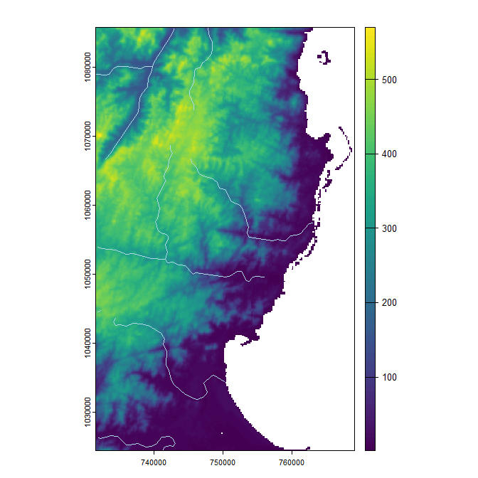

You can do operations on GRasters and GVectors as if they were SpatRasters, SpatVectors, and sf objects. For example, you plot them as if the were any other spatial object:
plot(elev)
plot(rivers, col = 'lightblue', add = TRUE)
Elevation and rivers

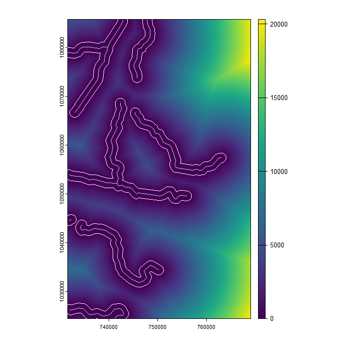

The following code 1) creates a raster where cell values reflect the distance between them and the nearest river; 2) makes a buffer around the rivers; then 3) plots the output:
dist <- distance(elev, rivers)
dist
class       : GRaster
topology    : 2D
dimensions  : 1024, 626, NA, 1 (nrow, ncol, ndepth, nlyr)
resolution  : 59.85157, 59.85157, NA (x, y, z)
extent      : 731581.552, 769048.635, 1024437.272, 1085725.279 (xmin, xmax, ymin, ymax)
coord ref.  : Tananarive (Paris) / Laborde Grid
name(s)     :         distance
datatype    :           double
min. value  :                0
max. value  : 21310.9411762729
river_buff <- buffer(rivers, 2000)
river_buff
class       : GVector
geometry    : 2D polygons
dimensions  : 1, 5, 0 (geometries, sub-geometries, columns)
extent      : 729629.19151, 764989.97343, 1022544.92079, 1087580.24979 (xmin, xmax, ymin, ymax)
plot(dist)
plot(river_buff, border = 'white', add = TRUE)
Distance between each cell and the nearest major river
