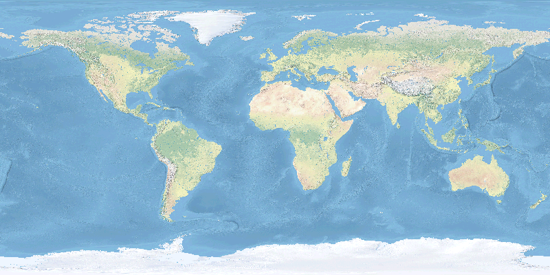

Display raster map
The Natural Earth raster is a global basemap with land cover and shaded relief rendered with a natural color scheme. Display the Natural Earth raster map with d.rast.
# Display natural earth raster
m = gj.Map(width=800)
m.d_rast(map="natural_earth")
m.show()
Natural Earth

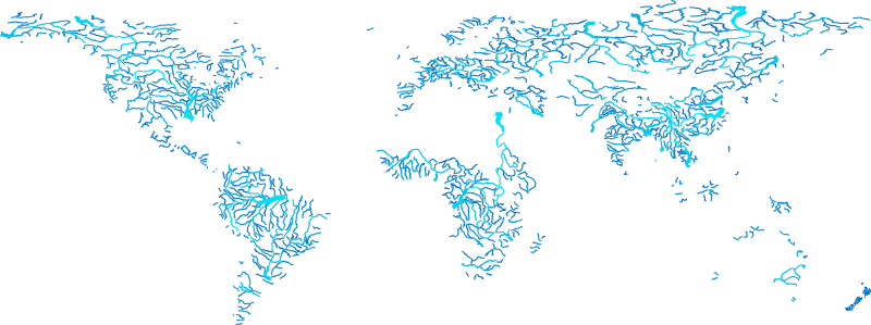

Display vector map
Now display a vector map of global rivers. First apply a thematic color gradient to the rivers based on their stream order with v.colors. Then display the map with d.vect, scaling the line width by stream order.
# Display rivers
tools.v_colors(map="rivers", use="attr", column="scalerank", color="water")
m.d_vect(map="rivers", width_column="strokeweig", width_scale=2)
m.show()
Rivers
